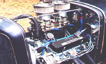

Posts: 135
Hey...
Two Q-Jets on a homebrew intake.. No issues, gREAT STREET CAR..
1931 fORD, 455 POWERED WITH 4:10S
pONTIAC sLIM

Hey, where did you get "PONTIAC" engraved on your M/T valve covers?

Join Date: Jul 2004
Location: Dixfield, Maine
Posts: 135
Hey
You like that eh?
Let me tell ya 1st off that up here in Maine its either Cheebie or John Deere powered.
So I'm run'n this here 31 Ford rat rod with the Poncho power... get'n sick of "what size Chevy is that?"
Anyway what I did waz to go poke'n around in the local boneyard (not much to do up here either)
Found a couple of mid 80s Pontiacs, carefully took the emblems off, (outside body emblems)
Get rid of all the old "stickem" on the back, see your buddy at the body shop an get some new "stickem", put on back of emblem an put um where ya want, razor blade off x-cess and thats that.. Looks pretty good.. Now folks ask "what size Pontiac?". Gives me a better feel'n
Pontiac Slim

Looks great! I have the exact same valve covers . . .

Pontiac Slim, care to provide any specifics on the "homebrew" intake?.....thanks....Cliff

<BLOCKQUOTE class="ip-ubbcode-quote"><div class="ip-ubbcode-quote-title">quote:</div><div class="ip-ubbcode-quote-content">Originally posted by Cliff R:
Pontiac Slim, care to provide any specifics on the "homebrew" intake?.....thanks....Cliff </div></BLOCKQUOTE>
Hey..
e-mail me @
[email protected]
Pontiac Slim
