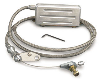

You probably wont have the bracket on the gas pedal for the switch,so you will either have to hunt down an earlier style pedal/switch assembly and wire it in,or use an aftermarket switch.
Lokar makes a nice adaptable cable/switch arrangement part #KD-2400HT.
Here's a pic of it.

The Lokar item is an excellent piece. Easy to install and works great.

That is my opinion too.
The one I have now was bought for a project but did'nt get used,but feel it will be worth holding onto for use in the future sometime.
Its easy to get it to "hide" pretty well if you want a "low key" type install,and handsome enough if your going to leave it in the open.
And I felt the funtion was certainly up to the job as well.
Simple wiring also.
Simply the best aftermarket option as far as I am concerned.
