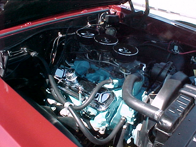

Phil is correct, it slips under the cowl edge. There is a raised lip on the front edge of the cowl. The seal slips under the raised lip and is held in place once you tighten the small screws that hold the cowl.
