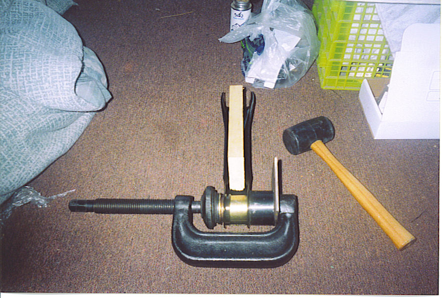

This tool I used to put in my control arm bushings in. IT's a ball joint tool, I used a steel plate to get the clearence to get the bushing in instead of the cup that the tool uses. It worked GREAT.

Heh that's what I used also. I used it to install my ball joints and then I saw could use it for the bushings too. Worked great.
