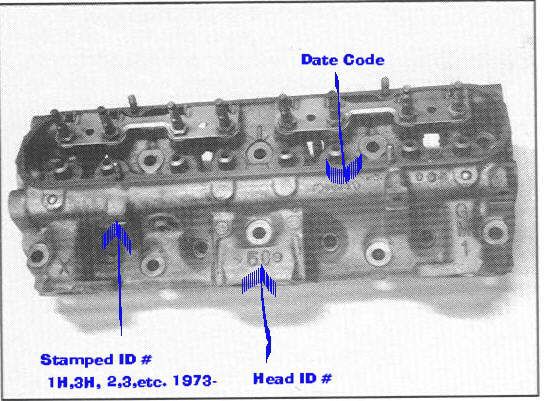

The 1H,etc. is stamped on the head.
Here is a pic.
johnta1

Ahh ok. The Head ID number is cast into the center exhaust ports Jag. Those are I believe 1975 400 heads they are about 101 cc's if I remember correctly. Very similar in potential to a set of 6x's according to Dave at SD Performance.

They are 4X 4H small valve heads...98cc. I'm assuming these would be OK on this motor for good low end??
