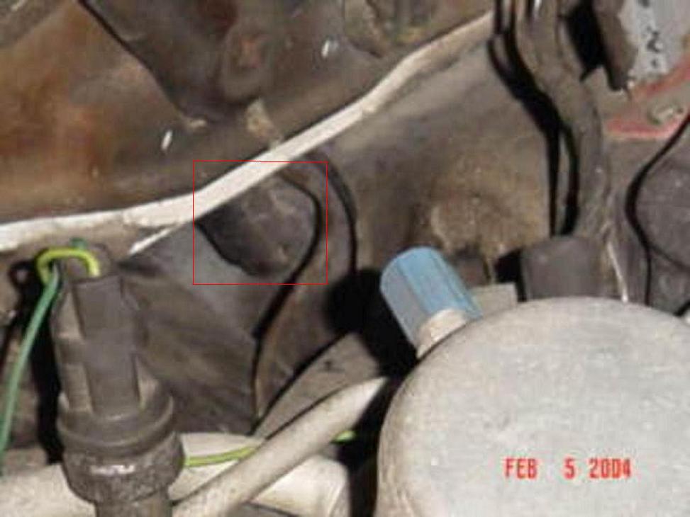

Anyone happen to have pics or know where the 2 prongs that come out of it on the bottom go to? Pics would be great but good defs of the plugs/wire colors etc would be great. There is also a hole to the right of them that I am not sure what it goes to or if something is supposed to be stuffed into it?
You can see it from this pic.
blower motor
Many thanks!,

Chris, I hope this works. I took a picture of the round rubber cooling tube that goes into the fiberglass A/C "suitcase." This rubber tube is to cool the blower motor. The end of the rubber tube has a lip which should catch the inside edge of the hole in the suitcase.

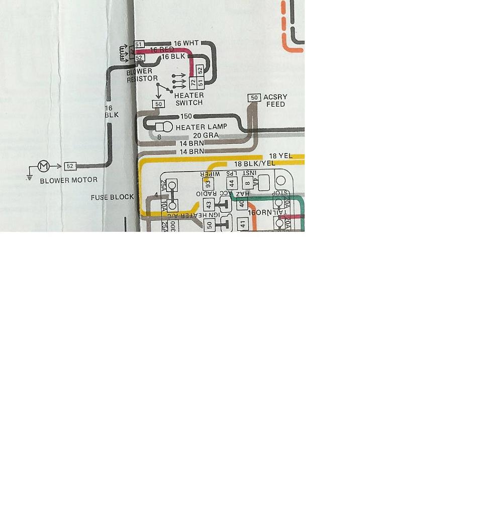

Here's the appropriate section of the wiring schematic for a 1978 T/A (VIN Code "Z".) I hope this helps. On my car, it appears there are 2 wires (Black and Tan) going to the blower motor.. however, I can't decipher the schematic to correlate with this. Perhaps you'll have better luck.
Best of luck, -Matt
