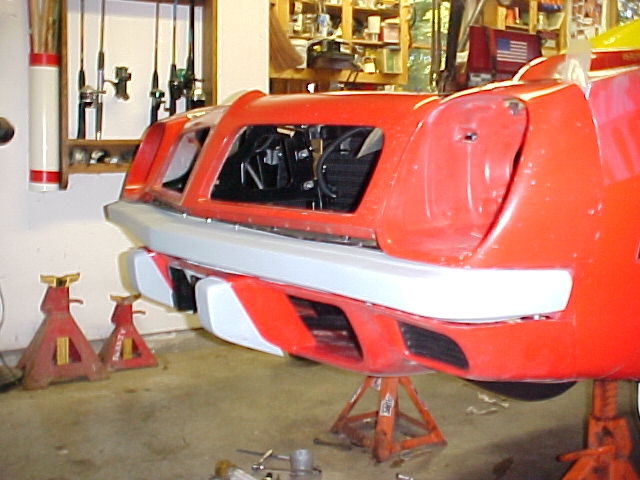

Got my bumper installed,you were right it just slides over front (a little snug)drilled 3 holes through it attached to front half on top behind filler panel also was able to attach the lower part by just installing front license plate holder brackets through fiberglass into there original holes.Everything is still intact except old rubber piece and bumperettes.

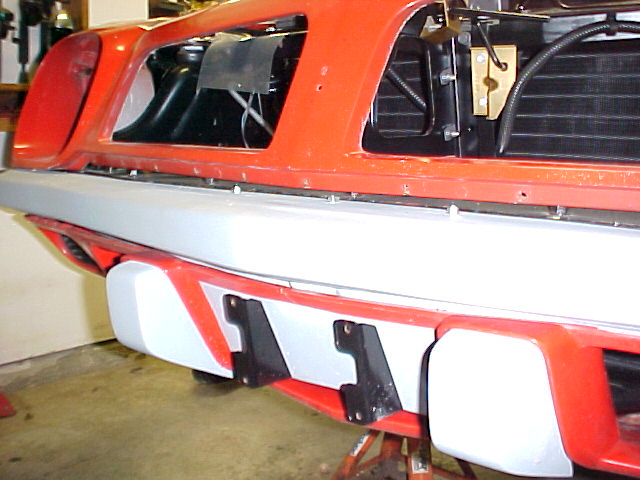

pictures(power plant & transmission will be removed this winter)

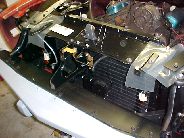

you can see the 5 screws across the top.

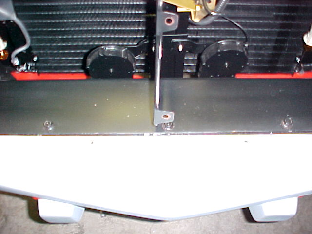

3 screws across the middle (hard to see)

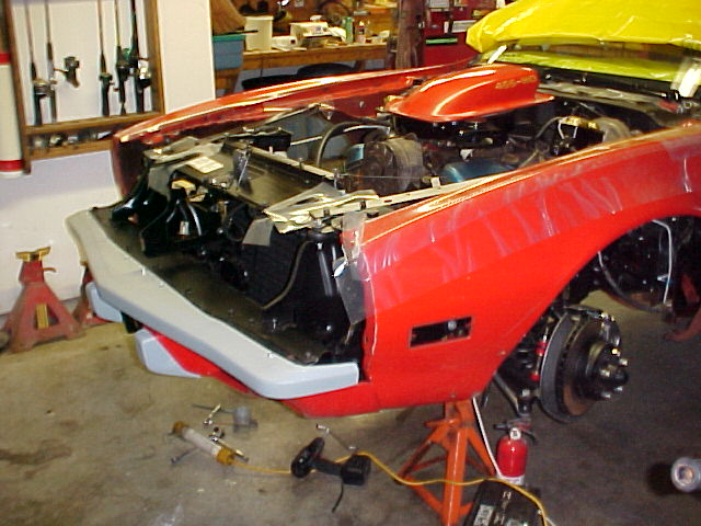

3 middle screws will be hidden by filler 2 outside screws hidden under headlamp holes in grille.

plate brackets back to original holes.Also good shot of 3 middle screws.
