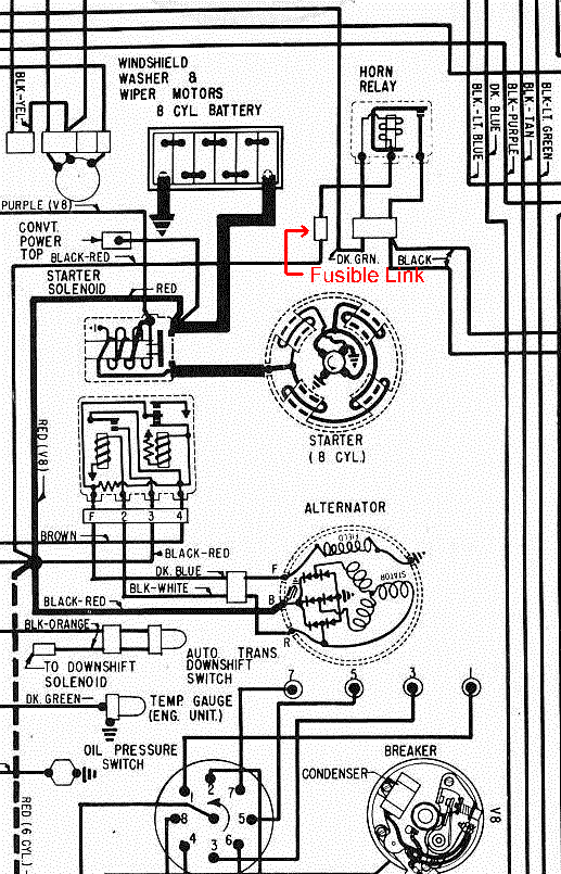

Toplessgoat: a schematic for the '65 a-bodies is now available in the elctrical forum courtesy of Bill Morgan. It does not show a fusible link but you've got to have a break in there somewhere...

In that pic,isn't this the fusible link?

I don't think so, John. If it is, it looks like it's the feed to the horn relay, the schematic doesn't show it continuing on to feed the rest of the harness. Maybe the big splice (shown as the big dot below and to the left of the regulator) went bad when the alt grounded the output (at least that what it sounds like happened.)
