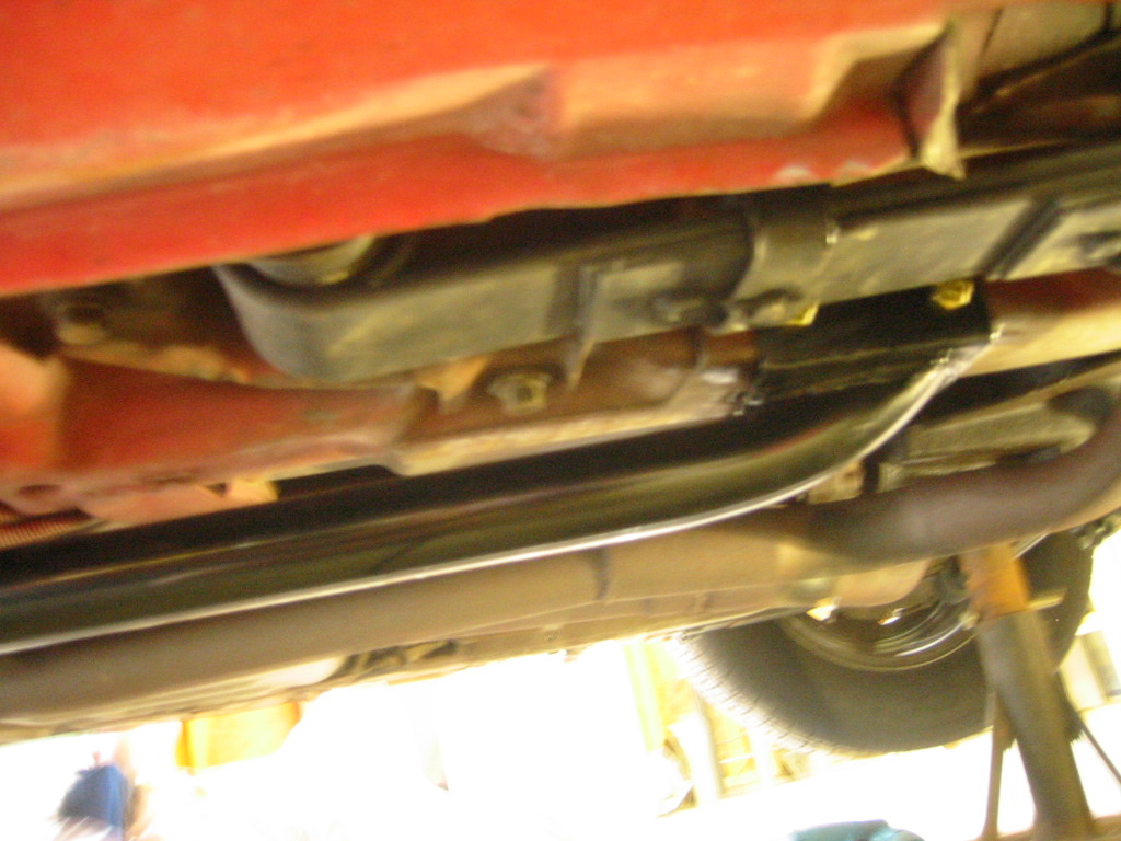

I put those on my 74 this summer, they fit good and tight against the floor pan, almost a little to tight under one part of the seat. Heres the best shot I got right now. The only problem with them was the front upper holes line up with the body mount, so I drilled new ones in the connectors.
Website is http://www.alstonracing.com/

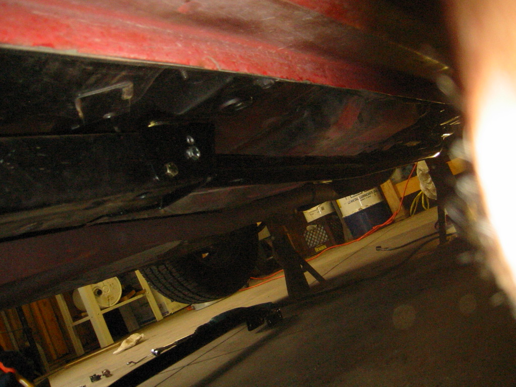

Rear part ofthe connector shot

I see how they fit now! My Moroso's seesawed over the floor pan until I resected and rewelded them. They do hang down alot more.

Skip, I actually had to dent one of those cross members under the seats to fit. You can barely see it in the picture. Use a round Sledge, hated to do it, but I already drilled holes in the frame, so what the Heck

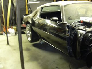

You mentioned that you bought the sub frame in marysville, wa. I live about 20 min from wayne's chasis shop. I think I will give him a call and stop by. Heres a pic of the wheels. The car was run on this combo before I took it apart for a new engine combo and suspension. I just went out and measured and got 26" with the nitto ddrag radials.

As I suspected, it looks like those 315s are sticking out the side. I am trying to avoid that, and I am not mini tubbing my car.

The 315's sit flush with the outside of the body they don't stick out and when the car is down on the ground it fills up the wheel well perfectly. I am jealous that you have one of those sub frames that thing is sweet.
