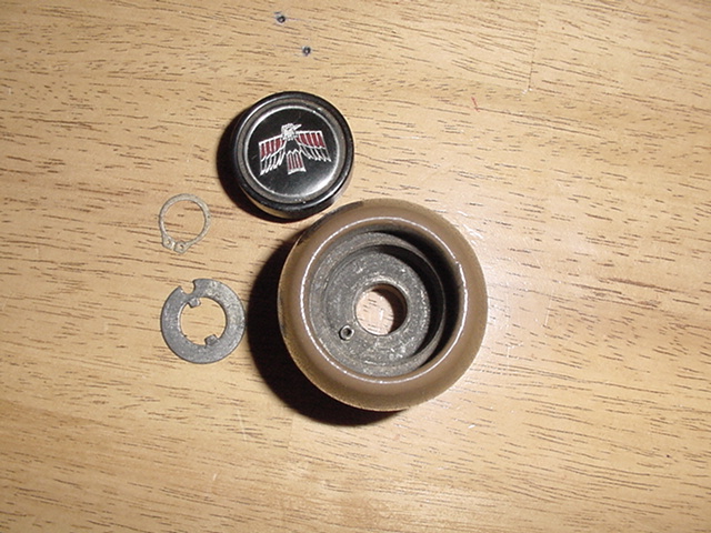

My setup (from the base up) has a c-clip, then the knob, then a special steel washer, the another c-clip, then the button. The special washer keys onto the shaft of the shifter and into a roll pin pressed into the knob.

So thats what they look like when not destroyed... anyone know where you can get one of these? Thanks for the pic..Geo

The one in the picture will go back on my 1969 TA (Whenver I manage to hide enough money from my wife to get the car painted). Otherwise I'd give it to you. I'll keep a look out for another. According to my assembly manual, the washer part number is 9797530. The GM parts system may still have it available as the same style floor shifter was used up to 1982.
