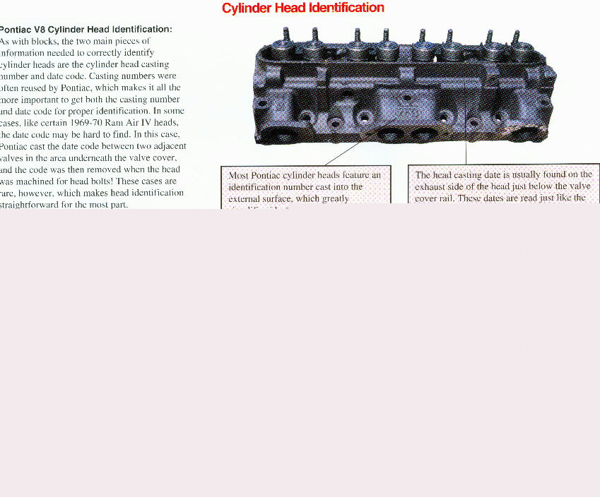

pic of head identification. greg

15's is not bad at all. I drive this car EVERY day and this is my first muscle car so im kinda anxious to get her up to par with the other muscle cars in the car club. Im guessing im would probably run 17's also with my current setup. After seeing the numbers for my friends car, i dont even wanna go to the strip yet. I still got reseal the tranny. Some bumb nut "fixed" the leak it had, but found out he did a horrible job when it was time for an oil change. He used orange silicon to stop the leak...and what a MESSY and HORRIBLE job he did! Hopefully i can drop into the mid 14's when im done with the engine. That's all im hoping for *crosses fingers*
EDIT: Thanks for the pic greg!

Do you know which cylinder heads you have? All of the 1970 350 engine had a #11 head casting number. These can be made to work well on a 350. They were rated 8.8 to 1 compression. Your block code shouyld be a YU or WU. That is found under the passenger side head on the front of the block. It is stamped in. There will be some other numbers above it. A combo that works good with these engines is the 4 tube style headers, (flowtechs i think have the cheapest that will work) avoid the three tube headers!!! You might as well stay with the manifolds before the 3 tubes! PY offers a nice exhuast system I would go with 2 1/2" dia back to a good muffler like the dynomax or Magnaflow (my favorite after testing) and then your choice of 2 1/4" tailpipes or 2 1/2". You won't notice a difference between the two sizes on the tailpipes. Intake wise go with a Edelbrock performer or if you want to look stock, any of the 67-72 factory 4 bbl. intakes (just make sure it is pre e.g.r.). If you don't want to change valve springs, the Melling 068 replacement cam (melling SPC-7) works great.(appox. $100) Avoid the crane "blueprint" junk. Not the same cam profile at all. Advance the cam 2 degrees. Set your ignition timing around 12-14 initail. Your total timing needs to come in alot earlier than stock. If you don't have Jim Hands book, you need it. He shows the right things to do. This should help liven that thing up.

The engine is a YU Code 350 with #11 head casting. My local checkers has some flowtech headers for $212 and hooker headers for $198. Would I need to get a new complete exhaust system or stick with the current duals flowmasters I have in car? If I decide to go ahead and change valve springs which cam should I get? I keep getting "Get the summit 2802 cam" advice. Is it good cam for my needs? What about the crane powermax, 216/216 .454? Whats the combo on your 350 Jagtec1? How much money did you have to spend? One quick question, what is the octane I will have to be using when done? I run 88 right now.
