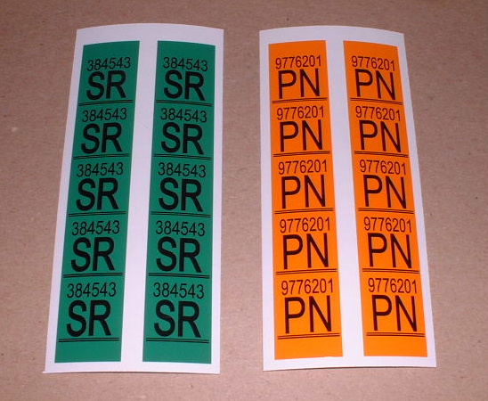

The SR and PN letters are the front and rear (respectively) coil spring tag codes. See photo, green is front, orange is rear.
