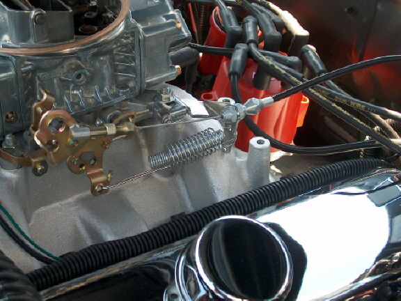

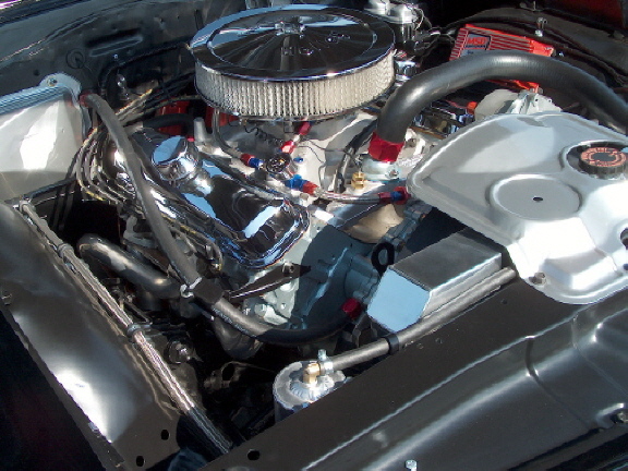

Thanks Bill and sorry it took me so long to get back to you. No thats not a performer RPM. Its an old Holley Street Dominator thats been bead blasted. If your going to run one of those after market fan shrouds, Make sure that the C nuts that they they send you with the shroud have threads in them. One of mine did't have threads tapped in it but the bolt went through. My first run down the road the bolt dropped out and the fan sucked the shroud into the fan blade destroying both. Fortunately it didn't touch the Rodney. Here's another pic. Keep 'em fast and shiny!

Sorry about that. I guess I better get to bed and get some sleep. Here's the pic I wanted to post. Go with the dual breather caps. It looks okay to me.

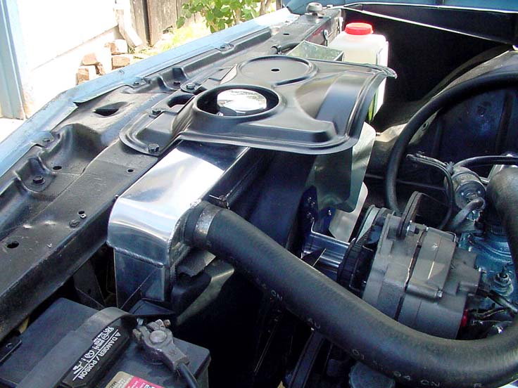

Brad, if you don't like the way your radiator cap looks get a billet one from Jerry at RR. I ordered one the same time I ordered my RR, it's pretty

Do you have a part number on that Lokar braket?? I'd like to get one, my 2BBL modified isn't what I want on my manifold, only one bolt holding it right now!

Sorry Larry H. so long to get back to you. Email Paul Spotts about the bracket. I bought mine from him and I'm sure he probably has the numbers memorized and probably can even sell you one. Paul turned me onto the idea and it does work well.

I've been working with Paul to get the part number....man he's busy. He sent me this information and wanted to see the picture so I sent him the link here...Blackfoot, looks like Paul might use your photo...cool
TCB01 cable bracket stainless $26 in stock
TC01 throttle cable - universal - $39 in stock

Bill, that looks real nice....thanks..
