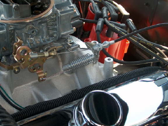

Nice looking engine Bill. I read comments about your throttle cable assembly. Here's a pic of mine. Lokar cable and throttle bracket. About $40. Nice clean set up. I bought mine from Paul Spotts. If you'd like some more pics and details on the installation your welcome to email me at home. Took about 45 minutes to install. Mark

Duh?!? Here's the picture.

That looks great, is that a performer RPM, looks like it?
