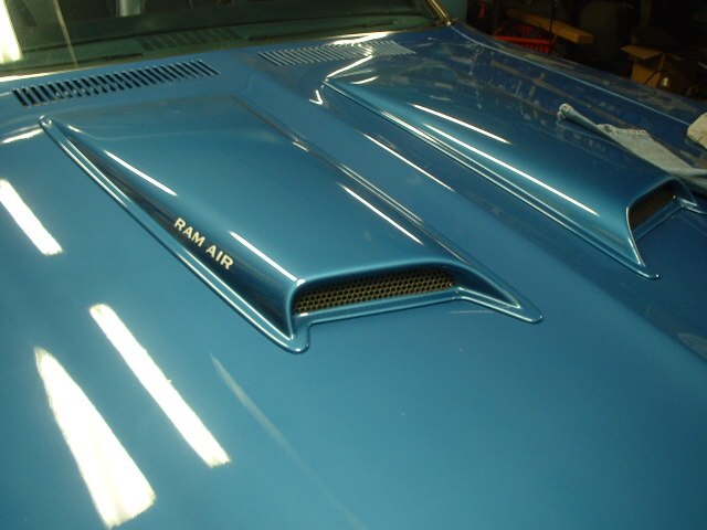

I was having issues with pinging, so in additon to some grinding the combustion chamber, I fitted cold air. In my reasearch, I found that unless you run a scoop like that of the 70-73 Formulas or 70-72 442 W30's, the cowl induction is the most effective, drawing from a pool of stable high pressure air at the base of the windshield. I considered cutting in to the cowl ala Jim Hand, but could not see doing that to a relatively valuable car. So I did this...
These are Lund Industries scoops, and I fabbed up an air cleaner to match the holes in the hood to accomplish this.

Scarebird,,I have seen many vehicles around using this exact Lund design and I have only seen one that looks stupid. Every one looks very nice on all the cars and the trucks as well. I have the larger bump in my hood that gets wider towards the back. I don't know how the Lund ones would look on that style of hood. Yours looks quite impressive though. Looks like someting the manufacturer might have offered as an option. Well suited to the hood, even though it is only a partial pic. Can anyone else offer pictures of various hood scoops for me to use as reference points?
