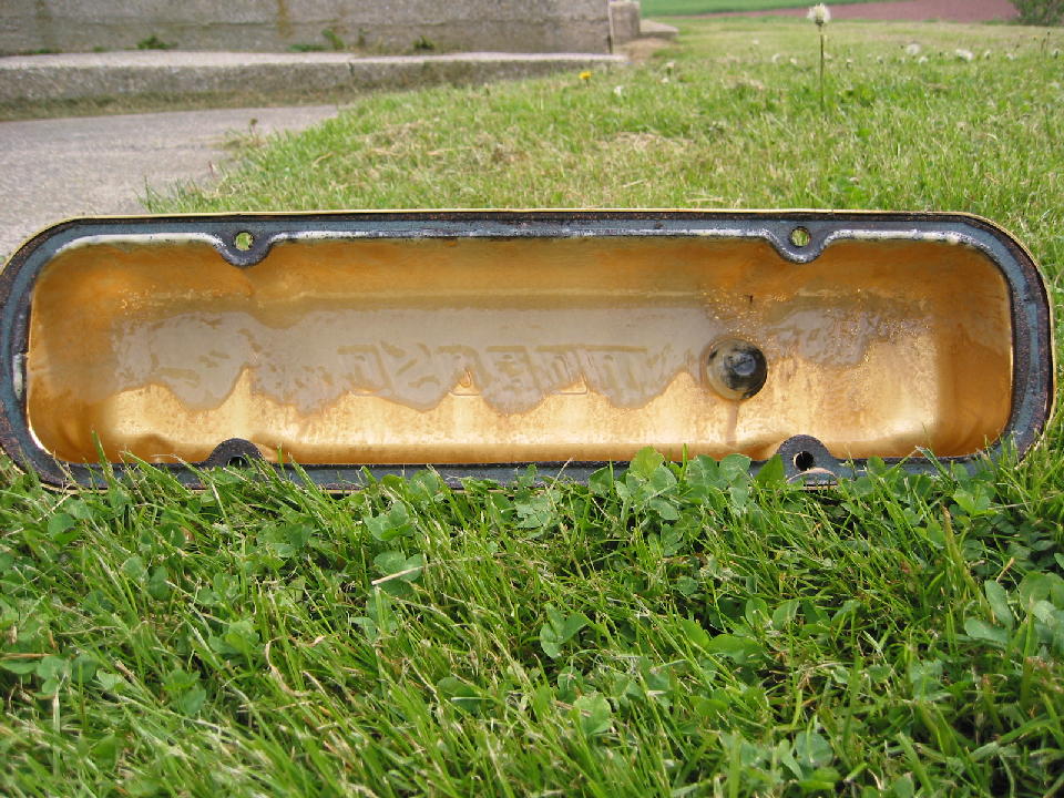

Here's a picture of the inside of the valve cover

E-e-e-e-e-e-wwwwww! Yuck.
BTW, I agree with George. If you pull the engine, you can go through everything. You can even have the block sent out and checked for cracks if you think that's necessary.

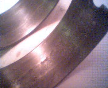

Here's what bearings look like after a little water mixed with oil go's through them.
