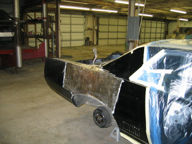

Went to check out the progress so far. It's absolutely amazing what a good metal man can do. (Bodywork being done by Precision Bodies, Schertz, Texas)

you need to post pics of the process. love seeing an artist at work

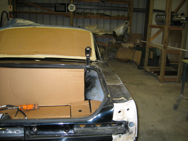

And another.

Pete: The body man told me that he will be using very fine wet sanding of the clear, not taking it down to the paint, and then he will be re-applying clear (8 coats) to almost the entire car. He says he will then wet sand off almost three of the coats to finish the job.
It's really interesting to see how they pulled the quarter panel out. They welded brass rods to the panel, attached a taut line to the rear of the car and then pulled on the rods at the same time they pushed from the inside. After getting the quarter pulled out they then cut off the brass near the base and then just ground the remaining brass off. Then he used a mallet and a form to smooth out the rough spots, constantly shrinking the metal back each time they thinned it with the pounding.
Fortunately for us the body guy told me that there had never been any major work done to the panel and it was still very thick and sturdy metal. That was a big relief to him, as he has more material to work with. He has also pulled out the dent around the door handle...you'd never know it was there. One of the best things about this guy is that he hates bondo and won't use it if there is anyway to get around it.
He says we may be ready to go by next weekend.
