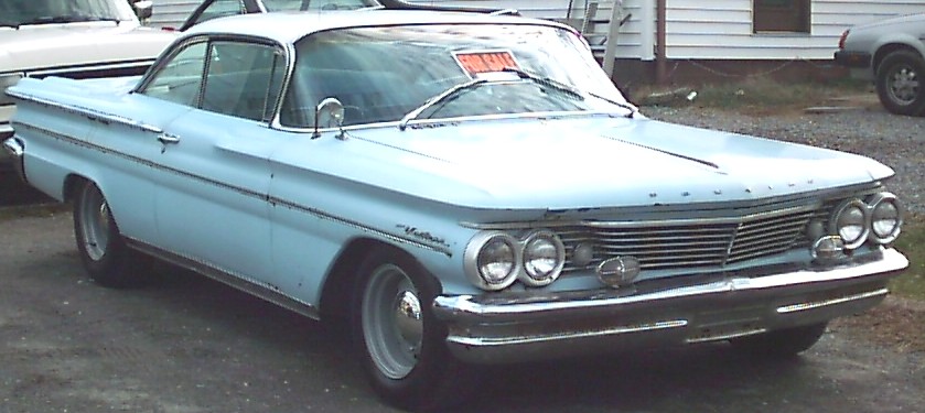

Old 12-28-2003, 02:28 PM
DL60 DL60 is offline
Join Date: Dec 2003
Location: KNOXVILLE,TN
Posts: 10
jack here are some pictures and thanks for the info

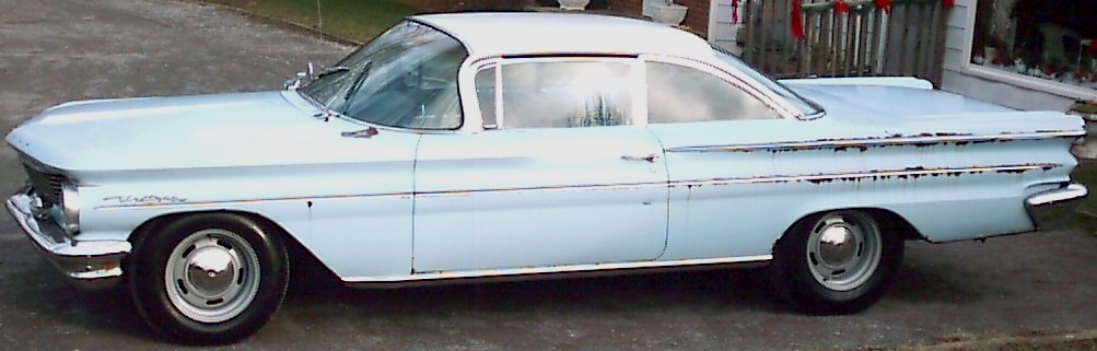

Old 12-28-2003, 02:38 PM
Join Date: Dec 2003
Posts: 10
i sent this picture because i have a question about the fog lights on the front can anyone tell me if these were a factory option or has these just been added on somewhere down the line i have searched the web for pictures but i have not seen another with these lights if they were just added on any guess on they are for.thanks david
Old 12-28-2003, 03:13 PM
Floyd Hand Floyd Hand is offline
Location: Dallas, Texas, USA
Posts: 518
DAL60, Not fog lights, parking lights from a Grand Prix, look to be 64, maybe 65.
