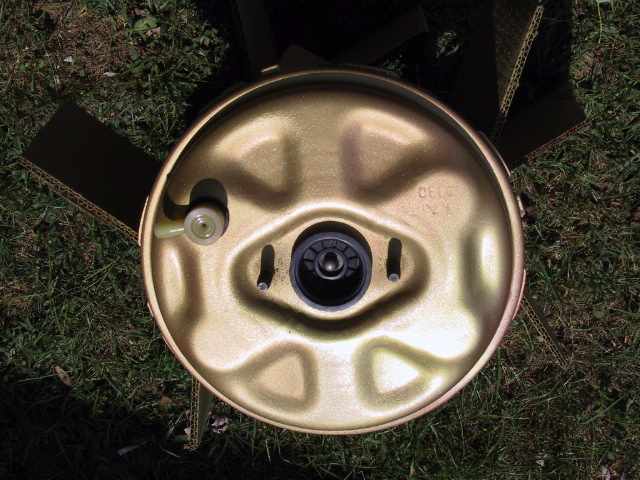

Well, it took me a while, what with everything else I've been doing, but I finally got the booster painted. I've attached two pictures. It's not perfect, but it's OK for a non-show car. It's a little rough where the master cylinder attaches, but that won't be seen anyway. All-in-all, I think it came out OK.

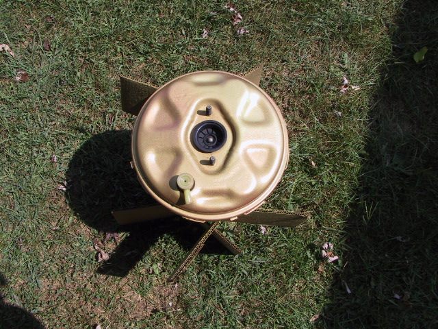

Here's a second picture....
