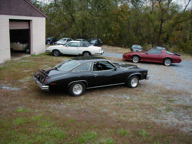

Thanks OPH
Its been a while since I had one of this body style. I now remember my Can Am hadthe g/p dash anf the coloun was a bit different. Its amazing what you forget and suddenly remember once youve been reminded!
