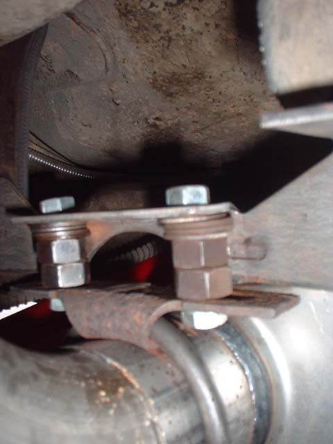

Well, I finally got around to taking a pic of the hanger piece and how I had to drop them down a little with spacers. Its not glamorous, but it works for now. At least you can see what the factory hanger piece looks like(rusty part)

Nice pic 428, I should have re-read this post before I started my install as I had the same issue. That original rusty piece pictured was not present on my car. Instead, the bottom half of a muffler clamp was suspended by the two bolts. I used longer bolts also, which dropped the rear of the mufflers. This helped in the clearance of the frame/shock tower above the axle and dropped the pipes infront of the mufflers as they were right on the floor boards. I still want to see if I can rotate the tailpipes inborad more to provide more clearance at that problem area over the axle and rotate the exits up higher into the quarters. Also same deal with the rear-most tailpipe hangers as mine exit below the valance. I don't know what other type of hanger would provide for a different position. 428 please post a pic of that rear hanger area at the quarter when you get a chance.
