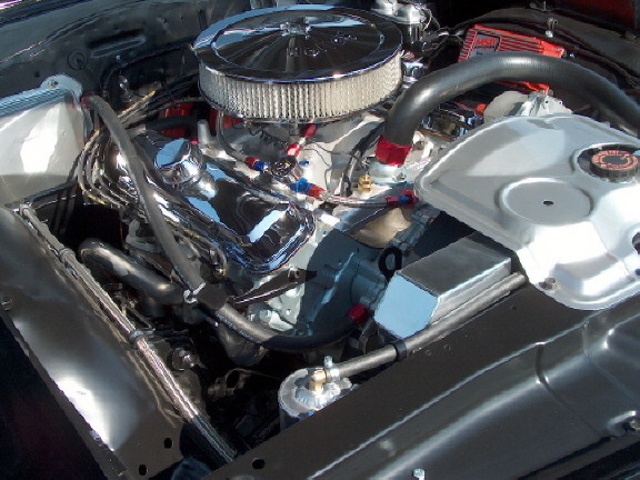

Super, I'd highly recommend the Rodney Red. I'm running one in my 67 Lemans and am very happy. They make them for TA's and Firebirds also. You can even have them modified a little. On my Lemans rad I had them weld the filler spout on with the overflow pointing at 1 o'clock towards the passenger side for a quick trip to the overflow can. I'm running a 180* T stat and even when I whip on her a little it barely breaks 200*. I'll use a Rodney in my Firebird project. Wouldn't think of using anything else. Pricey, yes but they do the job! By the way, loved your 66 goat on the History Channel!

Blackfoot, is that an overflow can in the picture...looks good!! Can I ask who makes it and how you installed. I have an RR as well and looking for overflow can.....
As fas as BeCool or Rodney Red. Based on extensive research before I buy anthing, I bought the Rodney Red. I am VERY happy. I run a 462 stroker and it keeps my engine nice and cool....

Brad, thats a Moroso. It comes with a mounting flange thats pretty self explanatory. If you've got a 462 you'll be able to figure it out. I bought it from Summit cause PY doesn't carry it.
