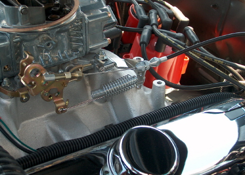

Get a Lokar cable and throttle bracket assembly.(two separate parts) You'll have to remove the assembly on the firewall where the cable passes through the firewall, remove the old cable, drill it out to 7/16, save your original clevis pin on your accelerator pedal. Throttle cable bracket is self explainatory but it does come with instructions. Abut $40 for the whole shebang. Nice set up, I'll never worry about mine again. Here's a pic.
