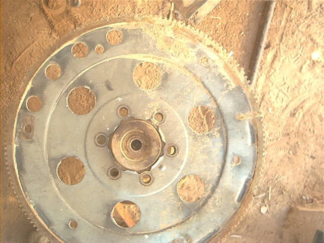

Old 08-21-2003, 11:29 PM
Steve Barcak's Avatar
Posts: 4,642
Here is a pic of a 370 crank standing on its nose showing the flywheel flange with a late type flexplate sitting on it. The bolt pattern is the same, the register is different. I spacer could be made at a modest cost. That would solve that problem.

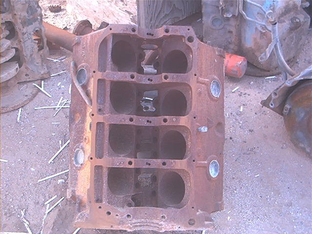

Old 08-21-2003, 11:36 PM
Posts: 4,642
Next is a bottom end shot of a 336. For those who don't know, the 336 was a small bore version of the 347 used is GMCs. Note the strenthening rib that runs the length of the block like the SDs and Ram Air Vs. Few Pontiac people know about this (you're welcome). 1955-early 1960 is similiar.

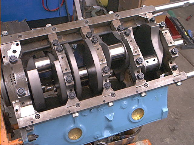

Old 08-21-2003, 11:49 PM
Posts: 4,642
Here is one of my bottom ends I designed about 10 years ago based off of the early block. All billet steel w/6 bolt mains, crossbolted and designed modular so you can check bearings between rounds when needed. The 5 main caps are all tied together for strength and support each other. On the front is another of my designs that supports the snout and , thus, creating a 6th main bearing. Then an oil pan adapter was built and then the pan was designed and built. There are no gaskets, everything is O-ringed. I have studied most all other high HP engines ( Hemi, chev, fords, etc.) and, in my opinion, this is the strongest lower end on any engine.

Old 08-26-2003, 11:17 AM
Taff Taff is offline
Location: uk
Posts: 353
That's a nice girdle Steve. I'm going to use a girdle myself on my next blower motor, it will be built around a 2 bolt block and will tie the (machined flat) tops of the two bolt mains caps into the pan rails,thereby preventing the caps/studs from flexing front to back.All caps will now support each other. Kind of like the girdles the 5.0 Ford boys use but with side pieces for triangulation. I'm baseing it on a 2 bolt block because of their easy availability and low cost.I'll post some pics when it's all done,which will probably be next year as I've just started work (play?) on my tube chassis station wagon doorslammer.
