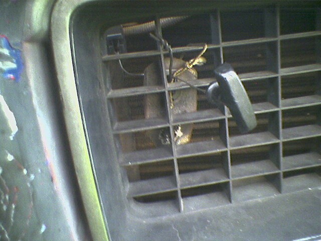

Here's the way it's set up right, now this is a pic of the plastic handle that pulls the cable going through the left grill vent. If you look closely you can see the bracket that's supposed to angle the cable upward into the hole behind the bumper. I figured this setup was "jerry rigged". But how would you open the hood in the first place if the handle would only be accesible when the hood is only held back by the safty latch and already "popped"? How would it be "popped" open?

yummy! the bracket hanging behind the grill bolts to the bracing behind the nose. there will be two holes, one for the bolt, the other for a locating tab on the bracket to keep it from moving. just below that plastic grommet you see on the center upright of the rad support is a small hole. a spring goes there and connects to a little plastic hoop that goes around the cable and takes up the slack. when put together right, the handle will just barely protrude through the opening below the grille at the top of the valance panel. you pull the cable, hod pops, then you hold it pulled to clear the safety catch, sometimes you have to push down a bit on the hood while pulling the cable handle after the intial pop to get the catch to release.

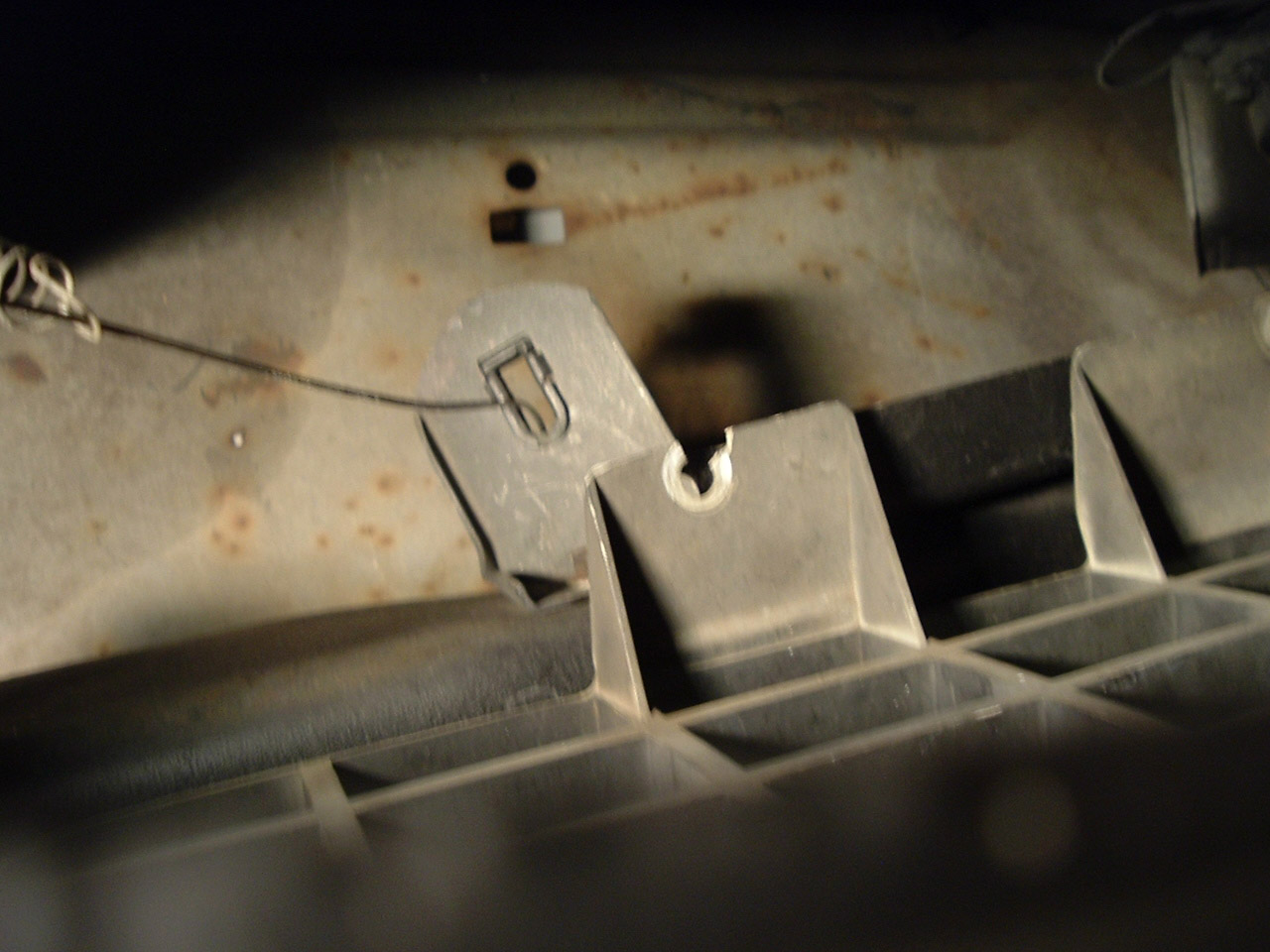

Here are rhe pics , basicaly Xbird described it correctly, hope the pics help.

nw s/d--omg, you're missing your plastic hoop on the cable! i'm amazed mine stil has all (ok, most of) the little bits after what it's been through. something tells me that formula 73's cable is going to be too short to connect back in the correct location, call it a hunch, but i think the cable broke and was tied to the latch somhow and the pictured rig was the only way to get it to work.

X byrd I don,t think I,ve ever seen a plastic "hoop" got any pics? hey thanks for the help. JF
