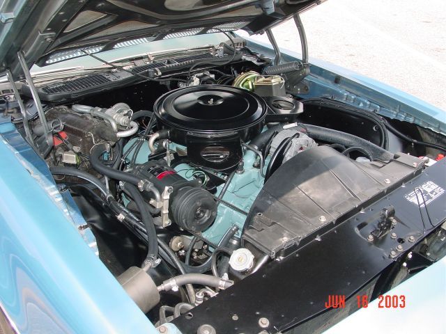

Crane full roller 1.5's, Erson full roller 1.65's, and currently Harland Sharp full roller 1.65's ALL fit under OEM Pontiac rocker covers. Of course, I ALWAYS use the FelPro Ram Air IV 1/4" thick rocker cover gaskets which give just enough clearance when using OEM covers.
BTW, the FelPro Ram Air IV rocker cover gasket set PN is: VS50005AC. Nice quality.
Hope this helps.

<BLOCKQUOTE class="ip-ubbcode-quote"><font size="-1">quote:</font><HR>Originally posted by disc0monkey:
do you think the compcams aluminum full roller 1.65 will fit?<HR></BLOCKQUOTE>
I don't see why they wouldn't fit.
I like the look of the OEM Pontiac rocker arm covers, and besides, all my accessory brackets fit just fine, as shown below.
