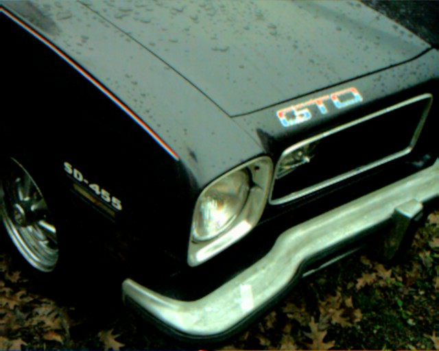

I remember in 74/75 my father had back surgery and my mom bought every car mag that was available for the 6 months he was off work. A few years later when I really started getting into cars my father gave me all his old car mags. I read in "supercars" I think of the "Motion" performance dealer installing SD 455s in 74 GTOs. The article I remembered was in black and white, but it did show a 74 GTO with the infamous motion stripe package and the words "Motion Super Judge" on the fenders. I have looked for years to find that magazine as I has hopes of 1 day replicating my 74 GTO into a "look-alike". My 74 still wears its SD455 badges on its front fenders, where they were placed on the Motion car by Motion. Other than that I heard there was also a company in Michigan installing SDs in 74 GTOs, by a person who was asking about my 74 being a real SD car. Hope this helps, and if anyone has that article I would be intrested in a copy, if you dont want to sell the original!

sorry after I reread the post I left, my 74s sd 455 decals were placed there BY ME, not MOTION, sorry for any confusion.

is it real or is it memorex......

LOL....sorry couldnt resist!
