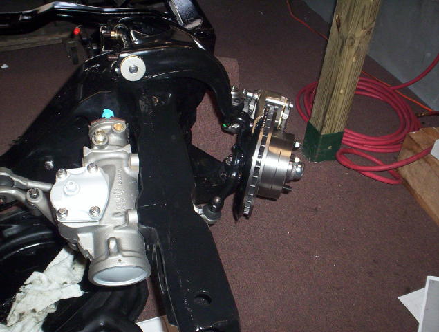

Well...I finally finished the brake up grade. I bought the kit from E-Bay. I'm sure you all seen it.
It worked out well and would recommend it. Just make sure all the threads are good and run a die over them if they are tight. I guess from shipping they get banged around and the threads get dinged up. They could do a MUCH beter job packing. I had to run a die over the spindle, (3/4 20 die) and the studs for the lug nuts. (7/16 20 die I think.) Going to get that now.
Here are some pics. Happy this worked out.
I do it right cause' I do it twice.

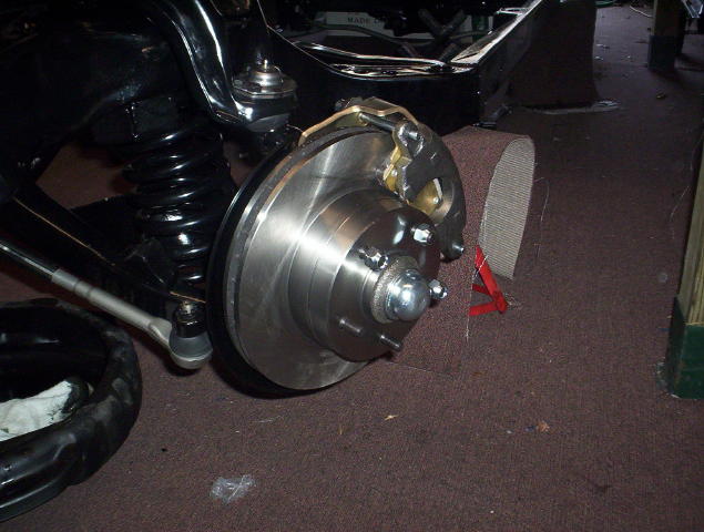

an another

You'll appreciate the extra stopping power & decreased fade with the discs.

Dang Dude, That is downright beautiful! Jim

Looks great but do yourself a favor and hit all none disc surfaces with hi temp paint or it will rust quickly especially if in non heated garage with weather fluctuations.

Not to be nit-picky, but your cotter pins are pointed the wrong way, your lug nuts are on backwards, and is that a scratch I see?
Just kidding dude!!!!
Looks fantastic! --Insert jealousy here--

Martin Senour cast iron gray works well on the areas where the pads do not make contact. It is high temp and will keep your system looking good.

Thank you very much.
I put some clear coating on all the brake parts for now to keep the rust from forming on them. I'll see how that goes. I will paint the calipers if I see rust. Everything else was powdercoated
Going to paint the rims today, Still have the original rims and hub caps. See how the car looks on wheels after 10 month on stands.
Wonder if the 14" rims will fit on with the new rotors? Any way next is the front brake lines, I'll be asking about them.

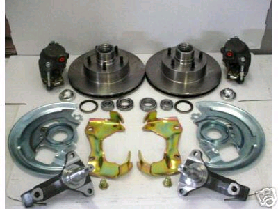

Was it this setup on Ebay - What else did you need to get to go from drums?

Halfway,
Nothing really..Like I said make sure your threads are good. You have to re-use the 2 bolts to the "J" hooks. It comes with a new "Boss" bolt for the top.
It does not come with caliper hoses, you will need to buy those seperate, although I think he may now sell at kit with them. Call and ask.

I take it you need a new perportioning(sp?) block and a new master cylynder and booster.
I currently have manual drums all around on a 64 Lemans.

Halfway,
That would be correct. I'm looking in that now.
