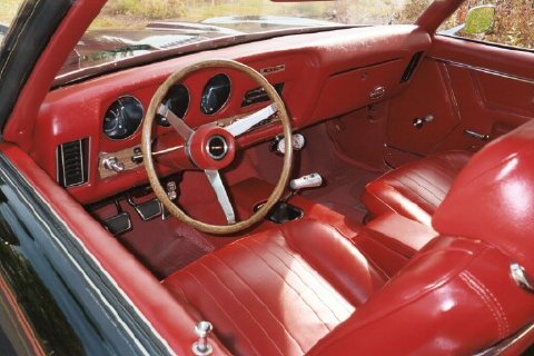

I bought one from performance years about a year and half ago for my 68 with a/c the fit and quality of reproduction was horrible. I bit the bullet and sent my original to just dashes, yes it seems expensive but well worth.

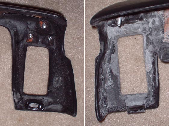

Here's a couple pics of the modifications I had to do to the air outlet on the reproduction dash pad. As delivered on the left, after modifications on the right. I had to remove the provided studs and install my own.

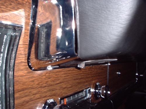

Here's how it fit on the dash.

Last pic. Conclusion...don't waste your money. Save up until you can afford to send your original to Just Dashes.

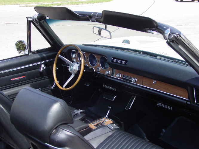

Save your money and go with Just Dashes!

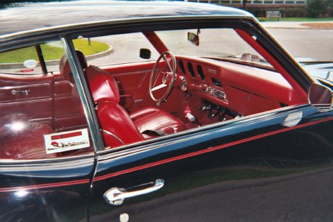

And Again...
