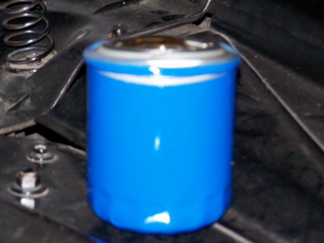

This could have been real bad. Not sure what happened but the oil pressure when I started the car up after changing the oil was over 100 psi.

I'd open it up and check the filter material is still intact.
My friend had to rebuild his 428 (running the 80psi SD pump) when a Pennzoil filter collapsed under the pressure and filled the engine with filter material.

hey mike, i had this happen to me many moons ago, it was a stuck oil pump pressure relief valve, it was stuck closed. when the engine started, the oil pressure pegged the 100psi gage, i heard a pop, then the oil pressure started falling. i replaced the pump and all was fine

It would be hard pressed for pontiac relief to stick. It is a large steel ball. If the filter has gone bad an damaged the engine, I would go back to the manufacturer and make a claim. It happens all the time and they pay many claims.

Thanks for the feedback, there must have been something wrong with the filter. I put a new one on last night and cranked up the car. Everything seems happy.

JUST NOTICED YOUR FILTER FAILED AT THE CRIMP...TYPICAL FAILURE OF "CHEAPER" FILTERS OR THEY BLOW THE SEALING RING OUT...

Oh trust me, they can stick. Had a rough experience that many can attest to at Maple Grove. Dumped about 6 qts at 120 mph plus. And on Video.
Car had about 20 passes prior and 50 since then.
After The Experience Changed the filter and rev'd engine quite high and a few times and it finally returned to normal. Went to Norwalk and raced the whole weekend. That's why I swear by Synthetic oils.
But when the relief was stuck. The needle came all the way around to the zero stop peg. Don't know how far is was going.
I now strickly use the Fram Racing filter with a higher burst pressure casing.

I've seen them stick open from trash getting in there, but never closed. It just goes to show you sh!t happens and Murphy (and his law) is our best friend!

I had a check ball stick in a 80# pump a few years back. When I pulled it apart I found a tiny little piece of metal wedged between the ball and case. Talk about a pain in the a$$
