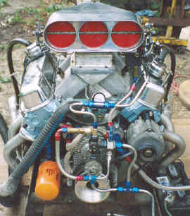

FWIW, I put some samples of fully cured JB "industro weld" immersed in methanol for 36 hrs. Surface was still firm, and still had exellent bond to aluminum. Only change was went from brittle to a very hard rubber consistency. I feel it is more than adequate for "necking down" the runner sides on my "Gutsram" based Enderle injection system. Should perform with gas even better.-Bob.
