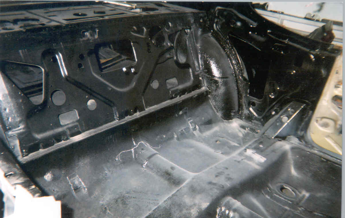

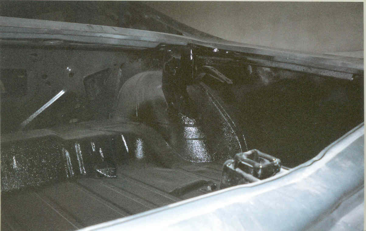

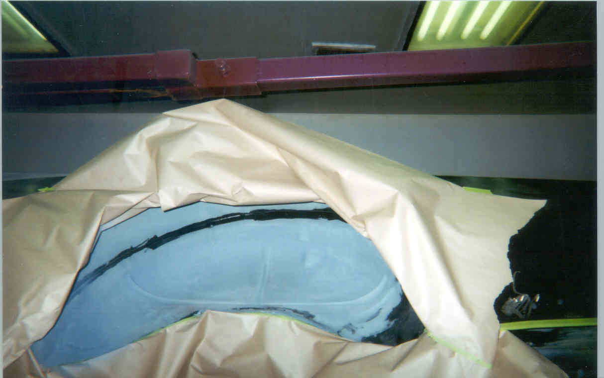

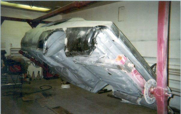

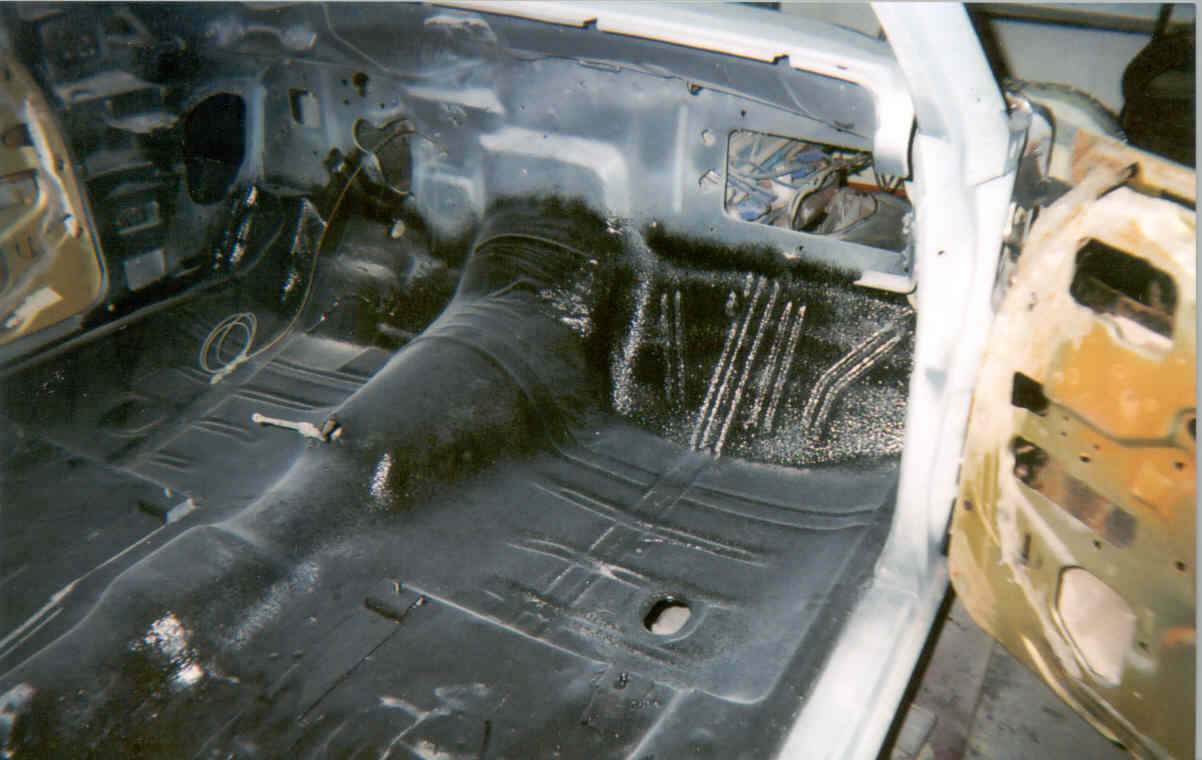

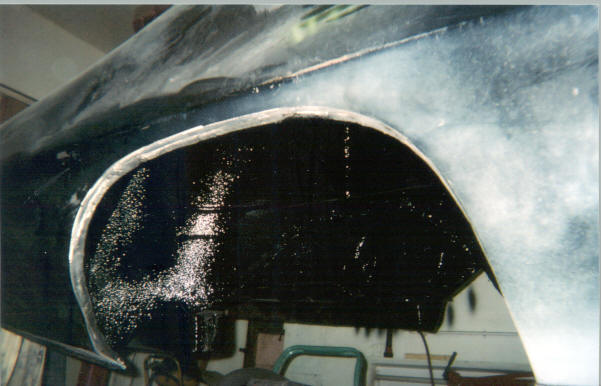

Here's what I found for photos:
1)Stripped the underside.
2)Primed and Seam Sealed
3)Wheel well with Bedliner applied
4)Trunk with BL applied
5)Floors front
6)Floors rear
7)Interior view, BL is on the inner wheelhouses and floor. The trunk divider is paint

Stu - thanks for the pics! shows me exactly what I am up against! I just wish I had that handy little rotisary that you have there!
My brother is restoring a 57 Chevy 2 dr, and I have talked him into doing the same. He said there is a bedliner kit available at Walmart...
I will be looking to get mine done so that the paint can be tinted the color of my car.
thanks again!
