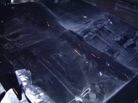

Give an idea of the process, here are some pics of my full-lenght floor pan replacement. I originally started on the left, but should have started the right - the center overlap required that the right to be in first.

Old 03-13-2003, 08:16 AM
GDK_1968 GDK_1968 is offline
Location: Perry, GA
Posts: 634
Large version...
