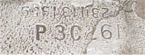

Old 03-15-2003, 09:26 AM
Held for Ransom's Avatar
Posts: 9,584
Imaginary transmission code out of my '73 Trans Am.
So long, farewell.
