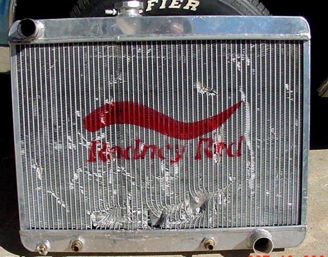

My flex fan was just scraping the bottom of the shroud, this was the result after it really hit hard.
