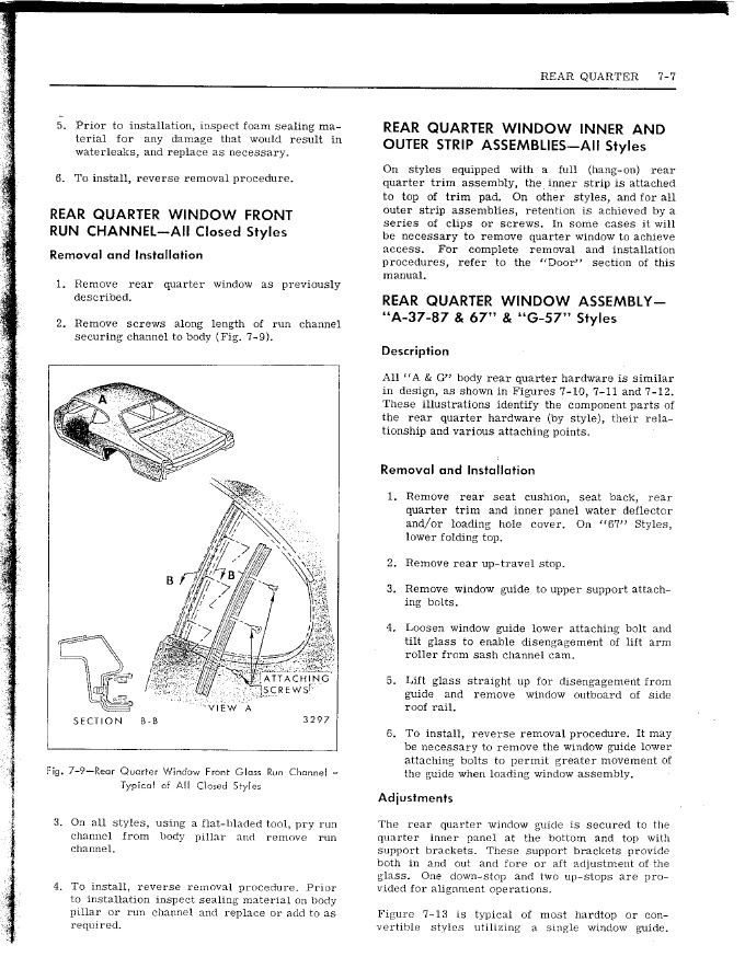

Here is a page from the Fischer Body Manual

Instructions were on the previous page.....

Burgundy,
Thanks for the diagrams, they are much appreciated. Much better knowing what is tucked away behind the small access holes!
