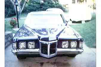

<BLOCKQUOTE class="ip-ubbcode-quote"><div class="ip-ubbcode-quote-title">quote:</div><div class="ip-ubbcode-quote-content">Originally posted by gpmodelj70:
As a FYI...there were no heads specific to the 428 HO...it was a complete package that made the 428 HO </div></BLOCKQUOTE>
I'd have to call the guy and ask him more questions, he might have just worded it oddly. This car has been for sale for several months now and I have watched the guy lower the price a couple of times. From the picture it looks good but the picture is only of the front of the car. I'll post a link to it. Someone should go look at it that lives in the area. I can't buy it right now anyway. Below is the info. I've been setting on it hoping to snatch it up but I think I'll get laid off in Sept. so I'm just going to give up on it. I'll post it in the For Sale section also.
1969 CLASS Classic / Antique
MAKE PONTIAC
MODEL GRAND PRIX
PRICE $5,500.00
LOCATION GOLDEN VALLEY, MN
CONTACT NUMBER (763) 545-5519
DESCRIPTION
1969 PONTIAC GRAND PRIX, SJ, 428 HO heads, at, hoodtack, 12 bolt, too much to list, $5500 /obo/trade? ;763-545-5519 GOLDEN VALLEY, MN
