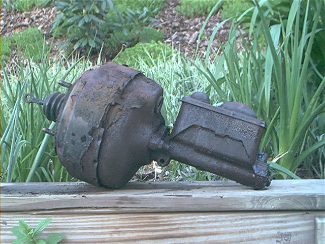

First- here is my original booster:

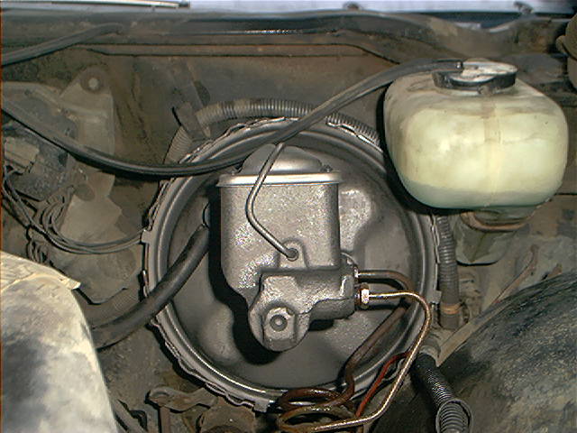

Here is the replacement booster they sold me. A very tight fit- not to mention this one was defective.

Man that old one is Crusty no wonder it failed lol. Just be happy NAPA still carries parts for a 30 year old car. Someday We'll have to pay top dollar for Repro Parts since the Napa/autozone Cant get them anymore. I agree though I have gotten the wrong parts more than once from Napa and Parts America. I find That Most Napa Parts Are better Quality. I only use Napa because The Clerk Is a Family Friend and I get the Parts at the Wholesale Price which helps alot.

Yeah, it was getting pretty bad. My entire engine compartment is dirty like that, but not rusty like the booster was. The engine in my car has obviously NEVER been cleaned- which really looks dusty after setting idle in a garage for over 10 years. I guess the booster was crusty after all of those years of brake fluid.
I plan on cleaning the engine soon- by spraying it with "simple green" cleaner (which has worked well for me in the past) and spraying it with a garden hose, rather than a high pressure sprayer. Then I can start painting the necessary areas and getting the only sticker I think I am missing- "Keep your GM car all GM" is missing from the air cleaner.

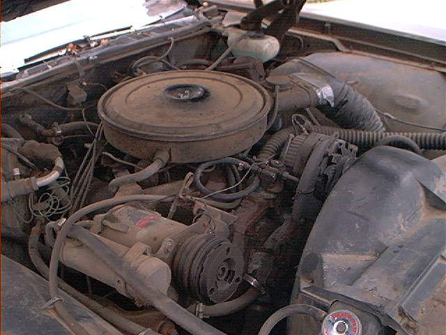

See what I mean- here is a photo of my engine taken after I bought the car- still looks the same.

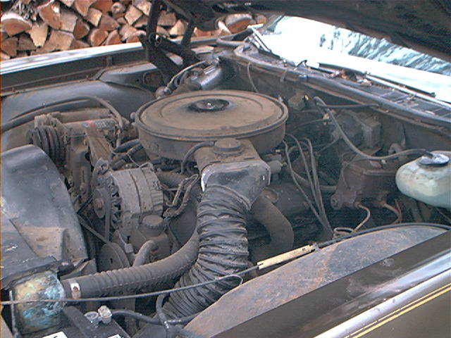

Another- of the engine
