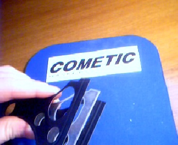

They're here! Price is high at $82.00 each, but at least they exist! Here's the details
For high end engine builders that do not know, COMETIC gaskets are taking over the head gasket world. They are possibly better than copper and o-rings for holding cylinder pressure, able to control water without leaking like copper, and can be re-used several times. MLS stands for Multi-Layer Steel, three layers; outer layers are viton coated spring steel, inner is 304 stainless
Gasket bore and thickness:
4.300" bore .040" thick
4.300" bore .054" thick
4.160" bore .040" thick
3.950" bore .040" thick
Above sizes are in stock, if you are looking for a different bore size, let me know it may be possible to get it during a gasket production run. You will be waiting a while before receiving special orders and it will be a money up front deal. But for you Super stock guys looking for every CC, I may be able to get what you are trying to find. Also available in special order is thickness range from .030 to .130 these will also be a wait.
Unfortunately for those running IA engines, at 4.350 bore and larger makes the fire ring land on the block water holes. For a big bore gasket to work, deck will have to be plugged, resurfaced, and redrilled with smaller water holes. If you have an IA block you may have done these things or dry decked your engine already. I may contract cometic for another tool to make these gaskets at a later date. If you are interested in sponsoring or co-sponsoring this project email me.
I can be reached at [email protected] or 1-419-560-1004, sorry I don't have a credit card machine, but I can take paypal using the email [email protected]

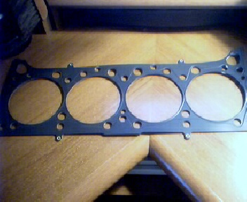

another pic

Rob offered to send me a couple of gaskets to evaluate and then pay for.
Not having tested his product, I can't say good or bad.
Larry and Bruce (Goatman) make good points about
cheaper stuff being available.
My opinion is I will never use his gasket or ANY
gasket on a fast (big HP) engine as I will have
plugged the heads for water and will be using a
stainless or Gas compression ring to seal the
combusion pressures. No gaskets, no leaks at
30 psi boost pressures. Marty Palbykin initially
used the gas rings I got him from Don Vesco (a
famous Bonneville Land Speed Record holder) but
the $400.00 for 8 rings sent Marty to building his own special solid ring. They worked as well and cost a lot less. Tom V.
