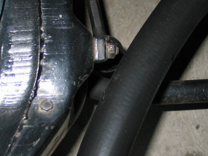

I get it. I only read your post under general tech. I misunderstood your problem. I installed a 1-1/4 bar from a 78 or 79 trans-am and had trouble with the tierod. Sorry, I assumed that's what you meant. Your problem is with the front bushing. you have it mounted too far back. If you are trying to use the stock bolt holes, you need to grind the slots as far in towards the bushing as possible, and use socket head bolts. Note in the pic that I had to grind the washer flat on the back edge.

From the top.This is how much clearance you should have. The idler arm does not move at this end. If you are only hiting it at a bump, check for loose bolts or ovaled bolt holes where the idler attaches to the frame.

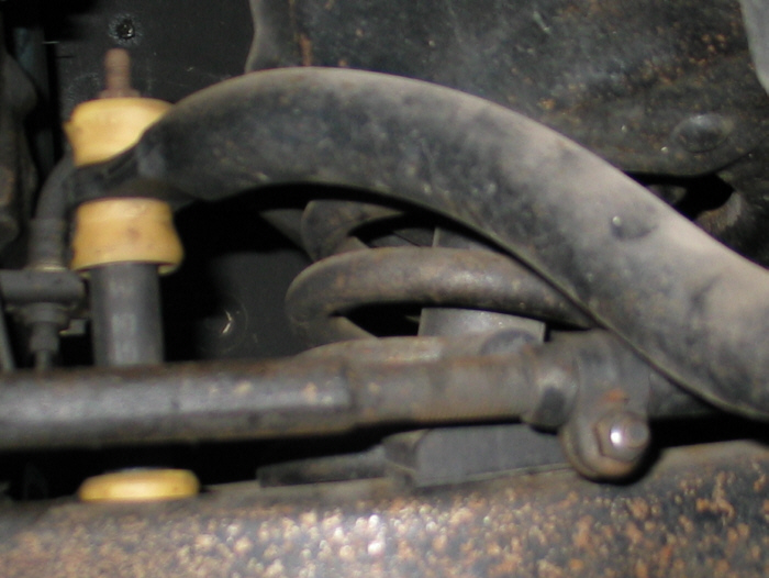

This is where I thought you had a problem when I suggested taller spacers.Hope all this helps.
