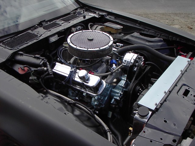

Are you governed by emmissions reg's where you live? If not, all that charcoal crap can come off no problem. I allways remove that stuff. The first thing I do to a car. One thing though, the gas nowadays has a higher evaporation rate. I do notice that carbs will loose there gas when sitting faster without the canister and crap. But it's nothing really, just evaporated out of the carb in a week or 2.
Get a open element air cleaner, if you don't have a shaker, which I see you have a formula so probibally don't. Just swapping the cleaner makes a dramatic visual change in my book. Also, get a set of cut to leingth plug wires and some loom's. Nothin says ugly like snaky plug wires.
Here's a pic of my TA all cleaned up

Thanks for the reply and the photo Zippy. This helps me alot. I already have put a different aircleaner on. It looks better. I still have the hose on the new aircleaner that connects into the valve cover. Can I get rid of that and just put a pop in breather (or vented) cap like you have?....That looks nicer.
I also see you have removed the A/C stuff. I'm thinking about that as well.
When you remove the cannister, what should (and where should) you plug off the connects?
Thanks for replying to this for me....The photo is great as well.

Yes, you can just add a breather cap in place of the tube to the cleaner. But keep the PCV valve. My AC was toast, no freon in it. I have just removed the lines right off the heater box and removed all the AC stuff from the car when I redid the nose. It used to be a 81, now it's a 78 I kept the box because I didn't have time to properly weld up the heater hole in the firewall. The AC and non AC car's have a little different hole in the firewall. So, I'm still stuck with the ugly box, but I sprayed it Satin black like the firewall and it doesn't stick out as much..
