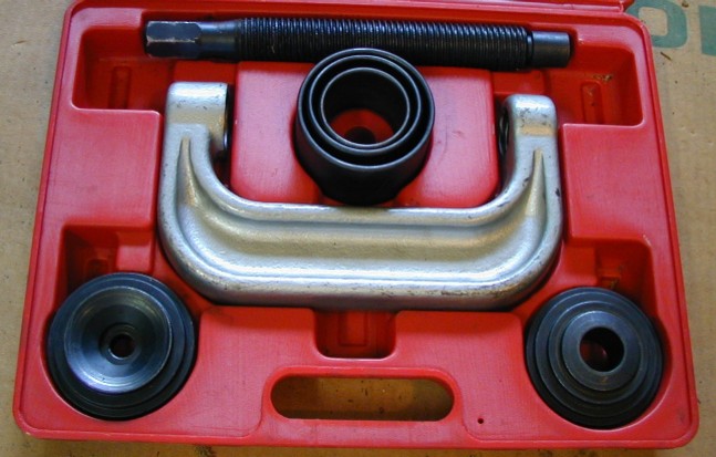

Autozone
Rent-a-tool
Ball joint kit. I just used it on my lower ball joints. Outside of the case says
"Ball Joint Press"
OEM oem#27023

I just went through the same thing and am now just getting it all back together. I used the press pictured by TD to press the lower ball joint out of the A-arm. To separate the lower ball joint from the spindle I used the BFH and pickle fork approach. Since I was replacing A-arm bushings anyway, I removed the upper ball joint and then took the lower A-arm and spindle off as 'one' piece. I found I could get better leverage with the BFH than when it was on the car. It took awhile, and I ended up bending my pickle fork a little. A torch may work too, but I was skeptical since I was reusing my spindles. Good luck.

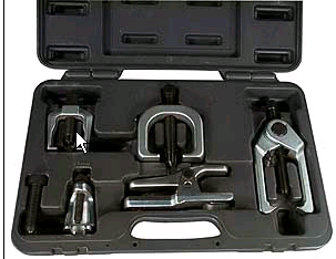

Bought a front end kit tool kit for ~80...everthing worked like a champ. I used the tool shown in the center of this kit (under the c press) to get the lower ball joint off the spindle...popped right off
