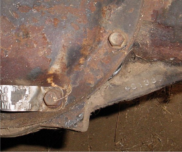

after examining my TA's rearend I've come to realize that the second set of numbers (CM G 066 2 G) is maybe a shift designation. Dating rearend can be done by looking where I've pictured below.

Held for ramsom thanks for the rear update,date code.I will get the other numbers when the snow melts.

held for ramson rear date is C23.Numbers on rim are M5 3 HM.Alternator 1100927 37amp 3C19 is 1973 March 19th? Full tag info

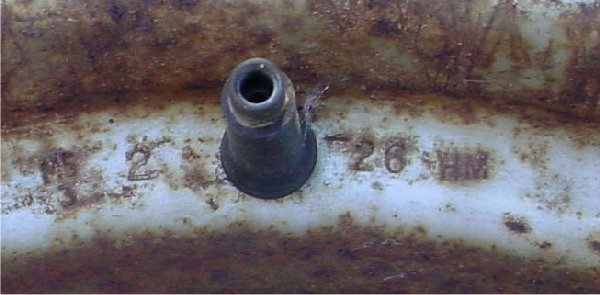

The date coding of the rim is shown below, looking on both sides of valve stem for numbers...2(Feb) 26.
You have dated your alternator correctly.
The 'A' in TRA (second line of trim tag) is throwing me as I've never seen it.
The head number is off, but the car might have had a problem early on and was fixed by a dealership.
All other numbers seem to indicate a numbers matching TA.
