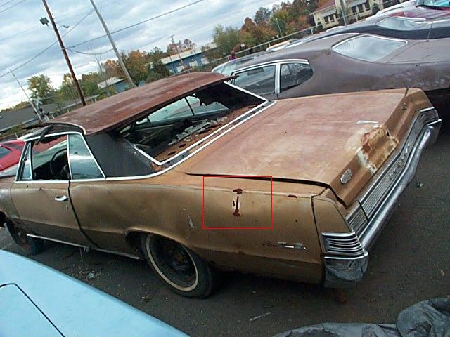

I would be intersted in someone's recommendation as well. Big question I have is how far up and around do the qtr pannels go. I have a dent on the peak of both Q-panels and was hoping the new one would cover that as well. obbyd don't mean to step on your post. Hoping between both questions we can get an answer

The 1/4s I purchased from year one went about 1 inch over the ridge line from front to rear. The spot you are showing would be covered with the new 1/4.

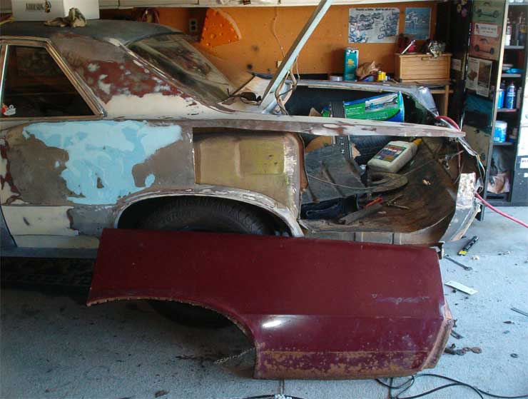

I had fears of cheesy Chinese metal qtr panels. The thickness of the original panels is pretty impressive, so I went on Ebay and got a Qtr panel off a 4 door Tempest in Texas, What a job that was, but turned out good. My first weld job...Only problem was remembering where the GTO emblem holes where, as I chucked the old metal BTW any body got the hole measurements?

Had to slam about 3 beers before picking up the Sawzall
