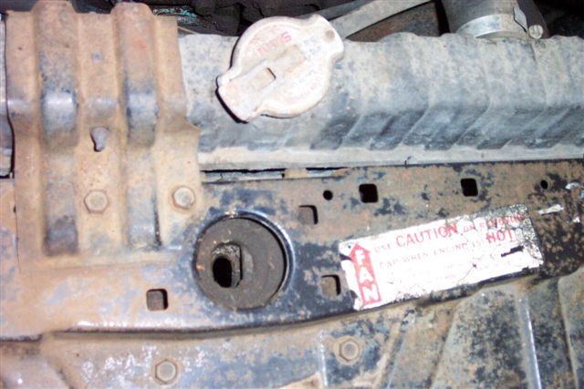

Can someone tell me the correct placement of the hot radiator caution decal when its placed on the core support? I could use a dimension from the edge of the return on the fender to the edge of the decal. Thanks!

runningman,
Here is a pic of my 67 core support. It's original. The decal is almost deteriorated away, but you can see the basic placement.
It's a Baltimore car if that matters.

I have seen the various locations but in this generial area this is an original but a 65

Good pics guys. I've seen them all over the place on cars with the full shroud. I don't think the guys at the factory much cared, as long as they got them on there somewhere. Generally, the cars equipped with only the finger guard had the sticker on there.
