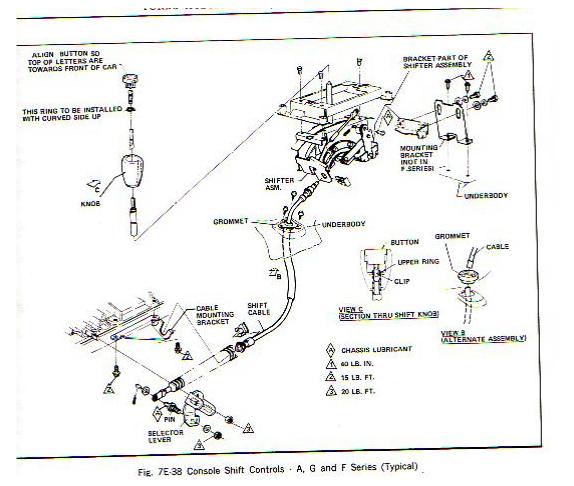

Here are a couple of pics that might help you I scanned from my 71 service manual.
Looks like you need to keep all the column stuff on to run everything. Or you could install a 68 shifter, they bolt right into a 72 console.
pic 1

Patrick

Looks to me like the cable goes on then the selector lever. Then the shaft & lever asm.
I don't see how your headers would ever fit past all that stuff.

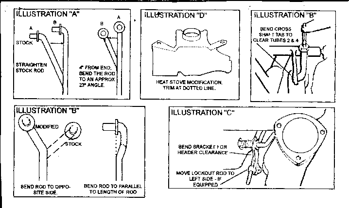

Thanks for the effort, Patrick. I have a '72 service manual so I've seen all this before. There is NOT a pic however of both the column setup AND the linkage from the column together. Here's a pic from Summit's website on installing their "house" brand headers. Shows how to re-manufacture (bend) the linkage to go around the header. (both auto and manual)I didn't bother to do the text instructions... pics show a lot.

Also I think some headers are made to go under the linkage(no ground clearance) and some that say steering lock-out linkage must be removed('cause the header goes right through the middle of it).
