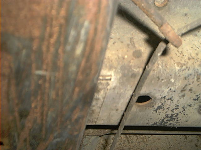

Thanks for the replies. I guess I will have to get some goggles and a mask and start sanding the surface rust. I crawled under there today and took some photos. The floors are very solid- just the surface rust as mentioned on parts of the frame. Not bad for a 33 year old car I suppose.
Here are some photos of my undercarriage.

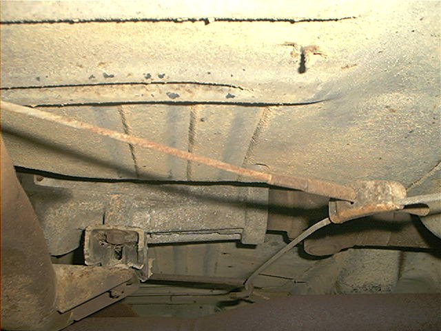

another

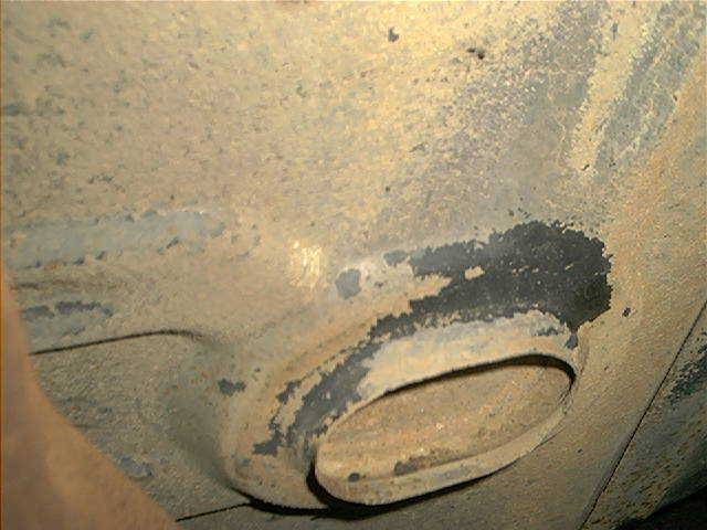

here is another

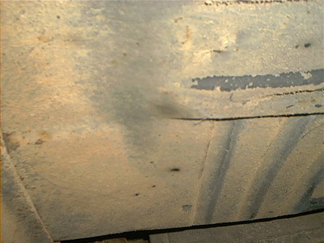

and another

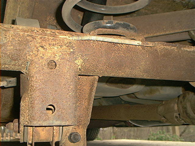

Here is one of the rear suspension area- you can see the surface rust I want to eliminate.

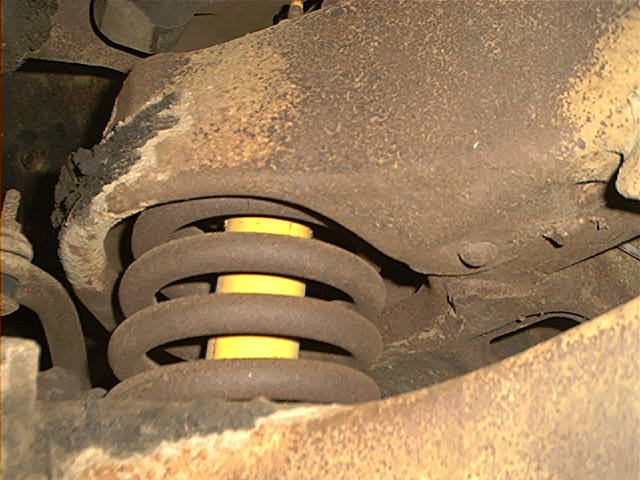

Posts: 532
one more of the front suspension area- again it is solid too, but surface rust.
