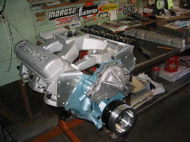

1.22" breather hole size ,they will not clear aftermarket full roller rocker arms,you ned to buy alluminum valve cover spacers if you full roller rocker arms .

pic

The boss they rub is all the way up so I don't think a spacer will help. They seemed to have room on my Norris SS and Crower SS rockers but only on mock up.

I have the HS 1.65 rockers, they rub the bolt hole groove on the valve cover. The second rocker from each end need to be rounded off a little to clear. There is plenty of room at the top for the polylocks and rockers. It is the big blocky pushrod ends that rub the valve covers. Wheelspin posted a good post last week on what you need to do.
