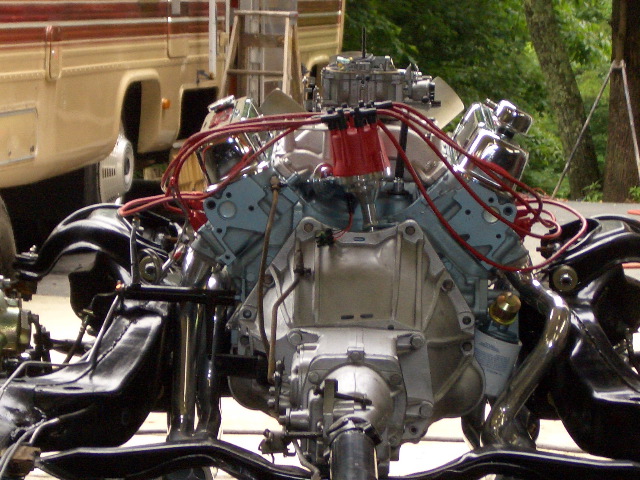

Fit great. You have to change the Oil Filter to a smaller one. It took an hour to crush the old one which was put on before the headers ( the Escalade Northstar filter works).

Fantastic pictures! Thanks! The HP-2 Fram filter would be be too long eh? How about the ground clearance? How far below the front K member under the engine would you say the headers hang? That is where I ran into problems with ground clearance with the Hooker headers. I do not do dry hops any more because of that problem. (Only in avatars!)

BigMike, Im pulling the motor from the car I just bought. Althought its a 64 Abody, the weight and hp and tracktimes are very close to yours, I mention that as reference to the performance of the Dougs on this car. I didnt measure the primaries 1 7/8? 3 1/2 collectors fit up very close, can barely see them under the rocker. 461/Eheads. I was surprised at the ease removing the Dougs, I expect they will reinstall without too much cursing. Coated, after nearly 3 years they still look new. Easy to see they are a quality product. Heavy flanges, beautiful welds, great clearance. Cant say about the filter, its on the firewall. If I were buying new, I would have to flip a coin on the MadDog or the Dougs.

Mike, I will measure tonight.

Ok Mike, Here is another pic. I measured and the space below the K member to the header is right at 2". The measurement off the ground to the lowest part of the header is 6". I don't race so I dont feel your angst but I hope this helps. By the way the problem with the filter was not length. It was diameter. We could not get it in or out of the header "cage".
