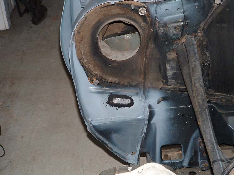

Here's a pic of the only number I found on the cowl....it does not come anywhere near matching my VIN though.
BTW, my rosette riveted dash VIN, data plate, engine partial VIN and the engine unit number as noted on the PHS all match.
